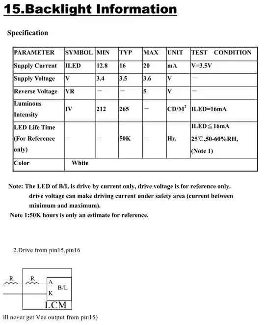

I'm a bit confused by the datasheet of a LCD (MIKROE-55). It says supply voltage is 3.5V (TYP), which results in as Supply current of 16mA.
At first I understood this as: "connect K to GND and A to 3.5V and I'm done :)"
But below that table is a graphic showing 2 Resistors (1 on seems to be on boards, 1 external).
So my question: How to connect that backlight? If a Resistor is required, how to calculate its Value.
Full Datasheet can be found here: Datasheet
Datasheet page

If you (both!)
  • have a 3.5V supply that is sufficently accurate
  • can live with a LED current that can be any value between 13 mand 20 mA
then you can ideed apply 3.5V directly.
For a higher voltage you must add an external resistor. For instance, for 5V you need a regsistor of 1.5V/16mA `= 100 Ohm.
