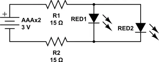

This led me to a result of needing 30Ω . So I bought a pack of 15Ω resistor, planning to put them in series in the circuit. Here is the circuit I planned:
schematic
I felt pretty confident in my calculations. When I put it all on the breadboard, I forgot to put the resistors in though before connecting the power source. As I connected the power source, I saw the LEDs light up, and realized I'd forgotten the resistors. I expected another spray of plastic shrapnel. HOWEVER - the LEDs just lit as expected, and there was no explosion. I then put in the resistors, and it did not change the output of the circuit at all. The LEDs still lit, and did not seem any dimmer for the resistors being there.
So apparently, 30Ω is not enough to worry about blowing an LED.
So my question is, how many ohms DO I need to worry about before adding resistors?

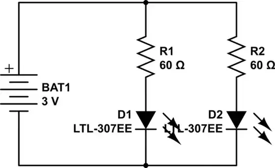

You said that in the first test, where the LEDs blew up, you used a 4.5 volt battery. That would force MUCH more current through the LEDs than the 3 volts you used in your second test.
The 3 volt test would still be forcing much more current through the LEDs than their maximum rating, and may greatly shorten their life.
What you should do is:
schematic
Since LEDs are not guaranteed to have identical forward voltages, if you connect two LEDs in parallel, with a common series resistor, one LED will draw more current that the other, so will get a little warmer, so its forward voltage will drop slightly, making it draw still more current.... which may cause one LED to be destroyed (not too likely) or one LED to be significantly brighter than the other.

  • After efox29's comment above, I went and found this question and was wondering then what the proper way to resistorize the LEDs would be. Your diagram is what I was guessing... cool. So you actually can parallelize diodes, it is just better to give them all their own resistor instead of sharing, yes? Or even with individual resistors is parallelizing still frowned upon? – eidylon Jul 18 '15 at 22:10
  • So the resistors also, while not apparently necessary in this particular circuit, would theoretically extend the lives of the LEDs, yes? – eidylon Jul 18 '15 at 22:13
    A recommended practice for multiple LEDs is as I show above - a resistor in series with each LED. Any number of these resistor/LED combinations can be connected in parallel (subject to power supply limitations). Connecting multiple LEDs in parallel, with a single series resistor is not recommended. If you have a high enough power supply voltage, you can connect several LEDs in series, with a single resistor. – Peter Bennett Jul 18 '15 at 22:15
    You ALWAYS require a resistor or other current-limiting device in series with an LED. Cheap LED flashlights often depend on the internal resistance of the battery to limit the current, but that's not recommended for most applications. – Peter Bennett Jul 18 '15 at 22:18
  • I was wondering about how that worked... my very first project I did with some lighting, I used the LEDs out of Dollar Store flashlights, and there were zero resistors in the circuits... but they still worked. That kinda set me off on some false assumptions as I started out. LOL – eidylon Jul 18 '15 at 22:20
  • @eidylon I should stated earlier in my original comment, that you shouldnt parrallel just leds together. My mistake, but glad you understand now. – efox29 Jul 19 '15 at 00:29
  • I would just note that you need one resistor per series set of LEDs. In your first test, you could have put the two LEDs in series and they likely wouldn't have burned out. If the LEDs are in series the current through them must be the same as eachother, which means the LEDs will heat up roughly equally and share voltage roughly equally. Also note that what you need is that the resistor is providing is current regulation in the form of a PTC(Positive temperature coefficient). So the actual rule is that LEDs are very difficult to parallel and each series set requires current regulation. – K H Mar 16 '20 at 18:22
