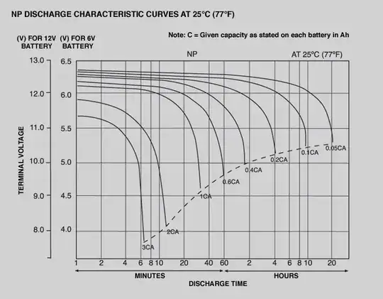

If you look at the discharge curve for a Lead-Acid Battery with a 12V or 6V rating:
Lead-Acid Battery Discharge curve - Yuasa
This comes from Yuasa. They make the things. It's either reliable or optimistic, certainly not pessimistic.
Let's look at the 12V one and optimistically assume that you are only interested in 0.2C discharge, any other rate the same arguments can be made with a different line.
At its 12V mark, you can see there is a "tipping point" where the voltage goes from relatively constant to plummeting.
At 11V it is almost going straight down.
At 9V it will drop right away under the same loading current.
This means that at the 12V point you have essentially used 60% of its capacity. At 11V you are at effectively 93%. At 9V you're at 99.5%.
Now adding that a battery with 0V across it has no chemical initiative any more, of any chemistry type, you will need to motivate it re-create the chemical imbalance that causes the apparent voltage and potential for current to flow. This is hard in any battery (which is why almost all batteries are built with electrodes already chemically built of the right materials to create the cell potential).
With SLA a lot of energy goes in chemical recombination of Sulphates and Sulphites, wasting a lot of energy. This results in needing excessive power to re-engage a cell that is left at 0V. Excessive power = heat. Heat = gassing. Gassing = moisture loss. Moisture loss = bad. Not to mention the higher voltage usually required makes many, many by-products on the plates, next to by-products already generated by neutering it in the first place and you're left with a AA battery with the weight and size of a 6Ah SLA.
Now, if you go near 9V, it will become 0V very quickly. You'll easily be too late.
Many manufacturers tell us "Consider your battery empty at 11.8V", some people (me included) assume 11V. Those who use 11V often (but not always) take care to know that this is the lower limit. This is exactly for that reason.
If they will not accept that 100's of manufacturers, countless experts in the field and users alike say "at 11.8V you're not going to get much more out of it and it'll be risky to try", then just convince them with the fact that at 11V there won't be much to get any more anyway. Done. All other points moot.

    The log plot with minutes/hours looks awesome. I'm just dying to know if the last line is 24 hours or what. – Vladimir Cravero Jun 24 '15 at 06:51
    @VladimirCravero The line end of 0.05C is probably 20.5 hours or so the graph end is more likely to be 32~33-ish. If you want it exactly you can use a ruler and maths of course. – Asmyldof Jun 24 '15 at 07:29

  • You give an example of the 0.2CA line: "(...) at the 12V point you have essentially used 60% of its capacity." For line 0.2CA, it crosses 12V at ~1.6h, and becomes vertical at ~4h. Therefore, with 2.4h left, you've rather only used 40% of its capacity (not 60%). Your argument seemingly becomes stronger at a lower CA line (i.e. 0.05CA). Due to the logarithmic scale, that last drop from 11.5V to 11V doesn't look like much. But that is still at least 4 hours, which is quite significant (+25%). Furthermore, storage at 11V is bad, but if you charge it again right after, there is not much damage. – Yeti Aug 30 '20 at 05:57

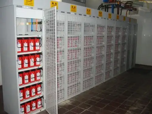

This is not a technical answer but some more fuel for your counter-argument:
I used to work in places that had LARGE backup battery banks (100's - 1000's of high-quality batteries) and those got changed out (ALL the batteries) at vast expense if they got cycled below the manufacturer's recommended limit due to a power outage. This was high-reliability critical telephone network infrastructure with legal requirements to stay online in a power outage (also nuclear strike, natch). You would see pallets of batteries awaiting recycling that would probably last another decade running Joe Normal's beer cooler in his trailer or similar, but this takes me to my point:
If you need guaranteed performance, follow the manufacturer's spec.
You can "get away with" all sorts on a car battery because you are not ever likely to reach its limits - typically they last for years, maybe if you discharge it to 2v you'll get away with it and it'll keep on starting your car under normal conditions for another 5 years, but that does not mean you didn't shorten its life by a year, or that if you drove to Alaska in winter it would still work, or that if you discharged it to 2v a few more times it wouldn't curl up and die. But as a consumer, you'll just shrug and buy a new battery, or have sold the car by then.
You can get away with a ton of stuff in everyday consumer life, but if you are trying to guarantee some performance of your device/product you can't break the rules (unless you're damn good) - this is why all those backup batteries got changed: They would probably still work fine to ~90% of the spec, but when the power goes out on a winters day 3 years from now, and that over-spec discharge event has pushed the batteries too far down the curve, and instead of having the specified 30 minutes in hand to get the power restored, the equipment unexpectedly goes offline 10 minutes early, crashes the network, and puts the whole system down for a day because the restore-from-dead situation is 10x worse than the "controlled shutdown" you're going to look like a right prat, and someone's lawyers are going to be knocking on your door.
Any battery manufacturer worth their salt will be able to tell you this data (and guarantee it), if they can't then don't be using their stuff for ANY critical application.
As a side note: Military vehicles get their batteries changed way more often than Joe Public's car battery for exactly the same reason - when you're being shot at on a wintry day you need to be able to crank your troop carrier into life 1st time guaranteed, not take a few tries with a bit of a rest in between.
This was a medium install, later replaced with many many racks of smaller AGM batteries: battery banks
Like this:
more batteries
And if they got cycled too deep, they would ALL get changed out. No question.
