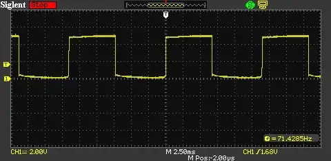

Now, what I've noticed is that when the PWM is running the fan at 100%, the tach signal (which is an open drain pulled up via a 10K resistor) is nice and clean:

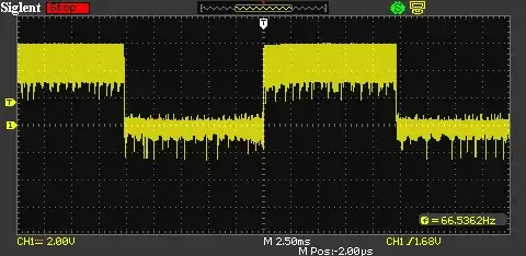

However, when I run at less than 100%, it's noisy:

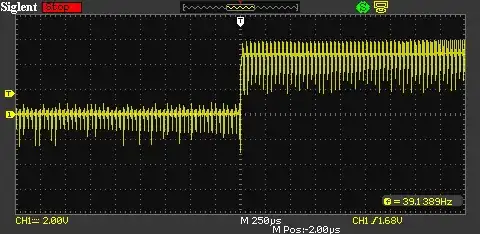

Zooming in on that noise:
tachdirtyzoom
I'm guessing it's being affected by the PWM signal but I would like to understand why and how so that I could clean it up if necessary in future. Really I'm interested in what you should do when you see noise like this, how you find the cause and how you "fix" it. The scope manages to trigger ok so I'm wondering if I just feed it to the external interrupt pin on the PIC (RA2), which is a Schmitt Trigger input with CMOS levels, then I won't "see" the noise and I could e.g. echo a clean signal out of another pin to fade an LED or something.

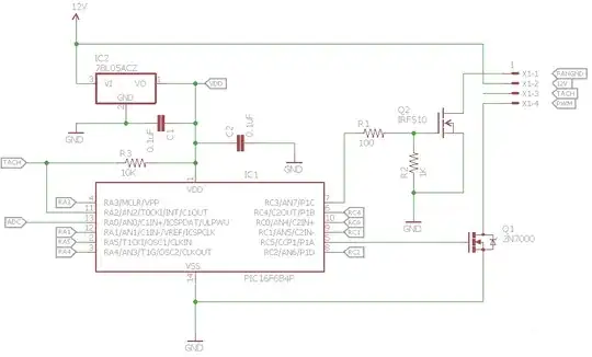

So can someone explain in general terms how to go about recognising and correcting noisy signals? Or if that's too broad maybe just this particular problem? Also if there's anything wrong with my circuit it would be nice to know too. In the schematic below, the signal I'm displaying is the TACH input at the left of the circuit:
schematic
UPDATE
After helpful suggestions from both @MichaelKaras and @techydude, I've ruled out Q2 as the source of any problem by removing it from the circuit completely and grounding the fan directly. No significant effect on the noise.

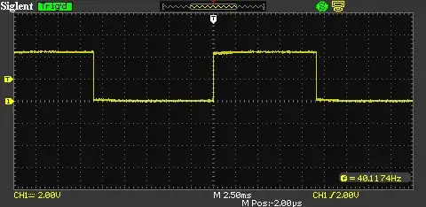

So I then coded the external interrupt on RA2 to echo a "cleaned" signal out of a spare pin (RA1 in this case), which helped a lot but was still flickering due to false interrupts. (So I'd set the interrupt to trap rising edge then switched to falling edge when triggered and vice versa, setting/resetting RA1 accordingly).
But, after also adding a 100nF capacitor across R3 (as part of @techydude's suggestion), I now get a much more stable output. The screenshot below is the TACH signal after cleaning via the Schmitt Triggered RA2 input and re-output on RA1:

About your schematic:
Everything seems fine, you can increase the R2 to 10k or even 100k, the capacitance of the MOST is so small, the FAN will have much more spinning inertia than the turn off delay in the MOST, probably even with 1M. That way the location of your 100R is irrelevant and while on you don't waste any mA's. If you never hold de uC in reset it's technically not even required at all, since your uC will actively pull it high or low.
For the PWM signal, you could see if the datasheet allows an external pull-up to 12V, though I doubt it will make much of a difference either way.

A problem in your signal is that the negative noise spikes on the high level and the positive noise spikes in the low level come very close to each other, so a simple standard trigger, even with adjustable level cannot absolutely guarantee you that you will never get confused.
