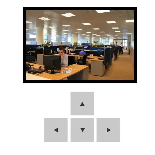

  1. Build a web interface like this:
  1. When he visits this interface from a remote location, he can press the buttons and (using an infrared signal emitter on our end) control a remote control car with a camera on it.
Any idea if something like this can be accomplished with standard web technologies? I have never done anything with robotics but I have heard about things like Arduino and tools like Raspberry Pi.
