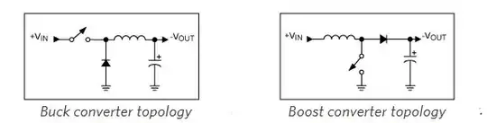

Switching regulators and switching controllers are very similar, and essentially perform the same function. Both of them are DC to DC converters.
Both switching regulators and switching controllers can be obtained/configured in either buck (output voltage < input voltage), boost (output voltage > input voltage), or both topologies.
The buck/boost mode is useful for battery operated circuits, for example you might have a 3.3v circuit, powered from a 3.6v battery which is initially charged up to 4.2v. The battery voltage drops to 3.3v while in buck mode, and then falls further below 3.3v where it uses boost mode.
The circuits uses a combination of one or more FETs represented by the little switches in the diagrams above) and an inductor to carry out their work.

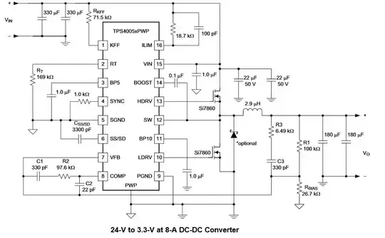

With switching controllers, the switching function is done external to the chip. This allows for much higher currents than switching regulators, since the controllers themselves don't have to handle the current -- just the external FETs which can be sized as necessary for the task. Here is a typical circuit for a 24v to 3.3v 8A buck type switching controller:
Switching controllers also offer a lot more configurable options, which is why this circuit is considerably more complicated than the previous one.
