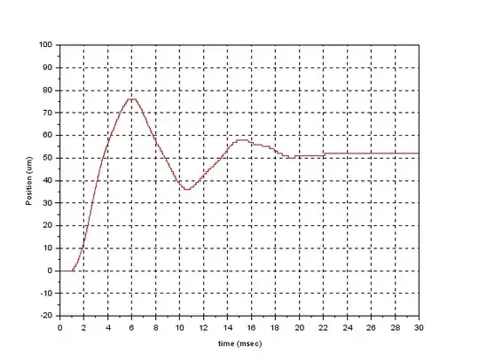

I'm working on a system involving a stepper motor that is used for moving a carriage back and forth in a linear motion. I have recorded the response (i.e. carriage position vs. time) corresponding to a single motor step. This, I believe, is what one would call the impulse response of the system:
In order to simulate the response to several consecutive steps, and to develop speed control strategies, I'm looking for a way to convert this time-domain impulse response into a frequency-domain (Laplace) transfer function of the form num(s) / den(s), if possible using open-source tools like Scilab or Python. What's a pragmatic way to do that?

  • This would be a step-response which the impulse-response can be calculated. An approach, is to convert the step-response to an impulse-response and then take the transform. – Christopher Felton Jun 05 '15 at 12:49
  • I am sure this has already been asked but I can't find the other question. That's a second order response, your fundamental frequency is about 100Hz (measure it on the graph) while the Q factor is a bit trickier, especially with so few oscillations. – Vladimir Cravero Jun 05 '15 at 12:56
    http://electronics.stackexchange.com/questions/117124/how-do-i-find-the-second-order-transfer-function-from-this-step-response-diagram – Vladimir Cravero Jun 05 '15 at 12:56
  • Of course you need to calculate also the DC gain but that's pretty obvious :D – Vladimir Cravero Jun 05 '15 at 12:57
  • Chris: this is the response to a motor step, which is actually a discrete event. There's no way I can move the carriage more than a motor step (approx. 50 um) at a time, which is why I was thinking of this as an impulse reponse. – geschema Jun 05 '15 at 13:07
What you call the response depends on what you decide the input to the system is. You can't treat the SM in isolation as it needs a driver, and that will have logic-level direction and 'pulse' inputs. So if, e.g., you define the input to the system to be a required displacement of 50um, the steady-state output will be 50um and your graph will be a step response. From this graph, the system has unity steady state gain and you can work out the transfer function from the overshoot and time to 1st peak etc.

From your graph, %overshoot=50%, Tp = time to 1st peak =5ms, therefore damping coeff is about 0.2, and Wn approx =640 rad/s (=about 100Hz); hence approx TF:
G(s)=411200/(s^2 + 256s + 411200)

This looks most as rotor stabilizing in new position or maybe the belt does the same. Either way i can't imagine, why do you need transfer function in open loop system. Just adjust speed and acceleration.
