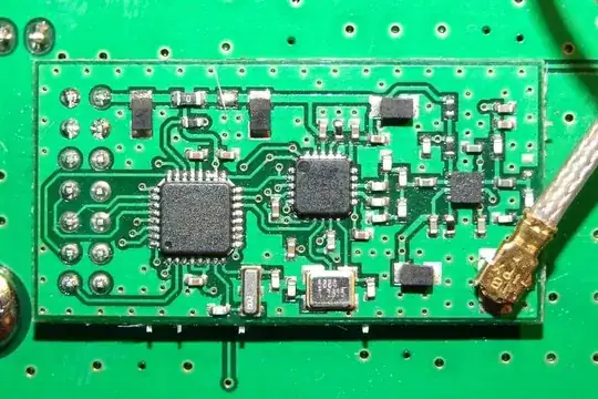

Here is an example of what I mean by using lots of vias to couple the pour to the ground plane:
Mark
  • 11,677
  • 32
  • 38
    Make sure your stitching vias are not too close to each other. The usual rule of thumb is to keep them at least one board thickness apart. This is because, since currents flowing on these vias flow in the same direction, mutual inductance between adjacent vias increases the impedance of the vias involved. – Mike DeSimone Jul 21 '11 at 18:30
