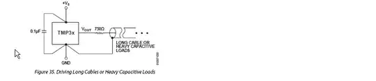

You need to put a capacitor across the TMP36 supply terminals and (preferably) a small series resistor such as 750\$\Omega\$.
There should be no such effect as you are seeing from a reasonable length of cable operating into a high-impedance ADC as your Arduino/ATMega should be.

  • Now I am totally comfused. The capasitors seem to have a small effect (I used 3-4 of them, even a 10μF electrolytic). The great effect occured due to the resistance value. For 25oC room temperature, a 1kΩ resistance gives about 21oC readings. a 10kΩ gives about 28oC. How is this happening? – user3060854 May 21 '15 at 20:28
  • You might need a capacitor on the Arduino input (at the board itself). It's possible to get crosstalk between analog inputs if the input resistance is large. You would not expect to see that if you are reading only one analog input. – Spehro Pefhany May 21 '15 at 20:41
  • Do you mean a capacitor between the Arduino input and the Ground? – user3060854 May 21 '15 at 20:44
  • Yes, that's where it should go. – Spehro Pefhany May 21 '15 at 20:46
