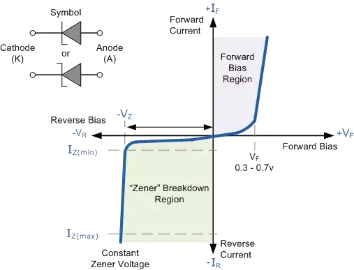

i posted the Zener diode grafic enter image description here see that , from -Vz to Vf it is not linear, and i thing it must have an effect on the input singal for ADC

  • @napon, on zeners, see the linked question. You hook the zener up so that it is normally reverse-biased, and the region of the i-v curve around $V_f$ doesn't affect the operation. – The Photon May 12 '15 at 18:15

  • @Dean, but according to the work area of Zenner circuit, it is nolinear, so i think the input voltage for ADC must be get affected – napon May 12 '15 at 18:00
  • @napon, the nonlinearity is why the zener doesn't affect the adc input until it's zener voltage is exceeded. – The Photon May 12 '15 at 18:07
  • @Photon, thanks a lot for your answer ! but before the voltage reaches the Zener Voltage, the signal voltag consists a part of voltag drop on Zenner, and it is not linear, so the input signal will also be nonlinear, it causes troubles for the accuratity – napon May 12 '15 at 18:20
  • @napon no, the zener does NOT conduct until the voltage exceeds the breakdown voltage, THEN it conducts, and THEN it will not matter because you've already gone past the rated input voltage for your ADC. Get a Zener which turns on/has effect after the working range of your ADC. 5V ADC, get a 5.1V zener. 3.3V ADC, get a 3.7V Zener or something. – KyranF May 12 '15 at 18:21
  • @napon, there are no ideal devices in the real world. If your source's impedance is low enough then it will be able to provide enough current to minimize the error due to the leakage through the zener. If your source's impedance is high, then use the clamp diodes to power and ground solution, also shown in the answers to the linked question. – The Photon May 12 '15 at 18:22
  • Note that the clamp diode solution also has a small leakage current. There is no free lunch. – The Photon May 12 '15 at 18:22

  • Let me explain what a zener diode is and why in theory it shouldn't have any effect on the signal of interest. A conventional diode has a reverse breakdown voltage of say 100 volt & operates in forward bias. A zener is a diode which is designed to have a low break down voltage, equal to the zener voltage, say 5.6V and the diode operates in reverse bias so that when the voltage across it is high enough it breaks down at the stated voltage. Diodes electrical characteristics have 2 parts: exponential I-V relationship in forward bias, in reverse bias, zero current flow until... – Dean May 14 '15 at 12:52
  • in reverse bias the diode has a very high resistance,so almost no current flows (only the reverse saturation current flows), until the voltage across it is is large enough in value (negatively biased) that the diode breaks down and the resistance drops massively and close to zero. If you examine the IV curve of a diode you can see this. A zener should display very similar characteristics to a reverse biased diode, just that the break down voltage is much lower. So a zener shouldn't conduct until the break down voltage is reached – Dean May 14 '15 at 12:58
  • As the voltage across the zener increases, its resistance should be very high and therefore should not affect what it's connected to (if connected in parallel), when the voltage across the zener reaches the breakdown voltage, then its resistance drops to close to zero (or low anyway). But ideally, go seek out the IV curve for the zener of your choice and take some measurements from it to be safe. – Dean May 14 '15 at 13:04
