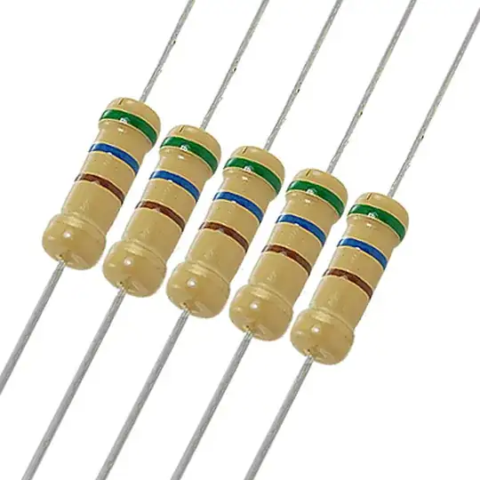

Yes, you can, if that is the only difference.
Composition resistors are a bit different from more modern carbon film resistors- they are more tolerant of surges, for example.
Carbon composition:
Carbon film:
If the resistors are of the same construction and of the same power rating (and of similar physical size- related to voltage and power rating) they will almost certainly work as well as the original. Voltage rating is not usually an issue on a product like an organ unless the resistor is connected to the mains. The same is true of surge capability (expand that to mains or power supply use). Don't replace a large resistor with a much smaller resistor (physical size) if you don't know the power rating.
