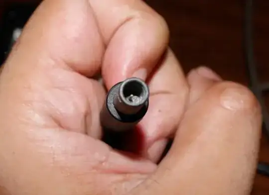

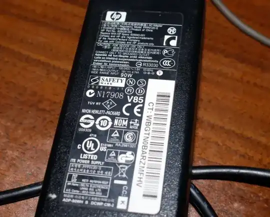

I have this HP powerbrick with a 90W capacity (19v 4.7A) that I want to use in my project. I am planning to use it as a power source for my 50W LED. But I want to keep the male socket it has rather than chop it off.
What I need is to know what specific socket name should I search in EBay to use it? Or can anyone recommend me a link and I can search it from there.

This is fairly standard connector, and can be found in abundance on Farnell
(http://uk.farnell.com/webapp/wcs/stores/servlet/Search?catalogId=15001&langId=44&storeId=10151&categoryId=700000004991&st=DC%20connector&pageSize=25&showResults=true&pf=110056900)
You just need to measure the outer diameter of the barrel and choose the one that suits from the above link.
I have narrowed the search by gender, but just check it is a female one you're buying!
Enjoy.
