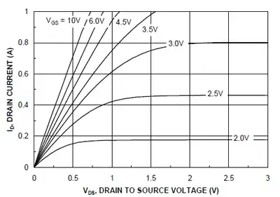

In the spirit of "a picture's worth a thousand words" most datasheets will have a number of graphs, relating two parameters against each other. You'll often see the same types of graphs again and again for certain components, and that helps comparing them. For a (MOS)FET for instance one of the most important graphs is \$I_D\$ vs \$V_{DS}\$,
and once you get acquainted with FETs you'll recognize this specific graph immediately. (Many design engineers will first look at the pictures in a datasheet because that's the fastest way to find specific information in a sometimes long document. That's why we graduated with honors in kindergarten!)

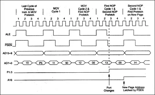

Microcontrollers and other digital IC datasheets also often have timing diagrams, again a picture which can tell a lot which would be difficult to explain in words.
Again, they're eye-catching, so you'll find them easily.

  • Timing diagrams can be nice, but one thing that's very important to note is that they are usually not drawn to scale. Further, the fact that an edge is drawn before another edge does not imply a chronological relationship between the two unless one is explicitly indicated (though diagrams will often show a repeated sequence of events, with different timing relationships shown on each; a timing relationship shown on one sequence will generally apply to all). – supercat May 11 '12 at 15:26
