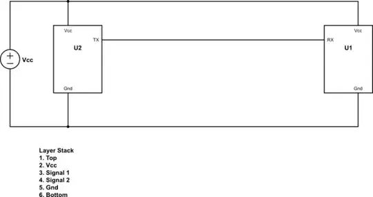

Consider the following simple circuit
schematic
If U1 and U2 are placed on the top layer and TX and RX are routed only the top layer, then the return path for the signal (TX to RX) would be Vcc. I'm ok with that.
My question is, when the return current reaches just under the TX pin, where does the current go ? At this point does it find its way to Gnd or does it go back into the TX and through the die, back to ground ?

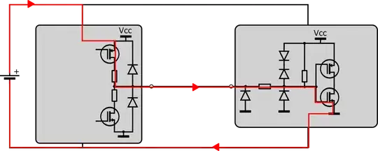

When TX switches low-to-high, the current flows like this:
Power supply Vcc -> PCB Vcc plane -> U1.Vcc pin -> U1.TX pin -> U2.RX pin -> U2.Gnd pin -> "return path" -> PCB Gnd plane -> Power supply Gnd
It's great that you understand that what we call the "return path" will be the nearest plane (in this case the Vcc plane). This makes sense as the fields can't read, so they will form between the metal parts in your PCB no matter what you name them.
In the static DC case, the "return path" will actually be the Gnd plane as that will have the lowest impedance. At higher frequencies, the fields will form to the Vcc plane and the current density will be high in the Vcc plane right under the trace.
So how does the current get from the Vcc plane and back to the Gnd plane for the higher frequencies?
Well, remember that the impedance between those two planes is fairly low at these higher frequencies. Actually we want to make the impedance between Vcc and Gnd low across the entire relevant frequency range as well (use something like PDNTOOL.COM to design that), so that is no big surprise (hopefully).

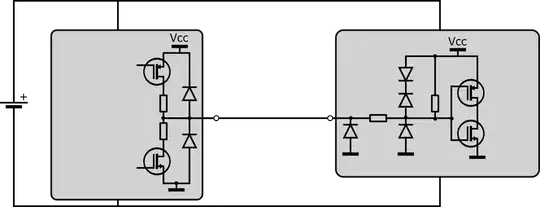

The return path wouldn't be via Vcc.
Think about it in terms of current loops, the TX drive stage & the RX input stage
Take for example this digital I/O (example I/O stages taken from ISO7221 datasheet)
Consider two states
1. TX is high:
In this instance there is an initial "blat" of charge to facilitate turning on the GATE of the RX buffer. After which there is only leakage current flowing (NOTE: this is overlooking termination resistance)
2. TX is low:
In this instance the TX stage holds the pin LOW facilitating current flowing from the pull-up resistor.
In both instances current flows from the +ve of the batter to the -ve of the battery.
Now consider from a PCB point of view. With a contiguous VCC and GND plane under the two IC's, the current that will flow will follow the traces - great small loop.
Lets say there was a break in the GND plane between the two chips, the route the return current would take would not follow that of the TX trace == bad.
