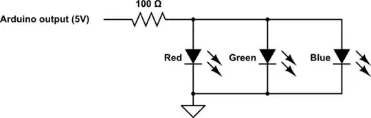

  • Okay, your schematic is different from my answer's guess. I've edited my answer accordingly. (I think the LEDs should all be connected to ground as well - is this an omission?) – Greg d'Eon Apr 07 '15 at 16:37
Now that a schematic has been added to the question, it looks like my guess was wrong - your schematic does have a separate resistor for each LED. My original answer is below.
It's hard to tell, but it sounds like you're doing this:
schematic
This is a Bad Idea™. The voltage across the LEDs will only be as high as the smallest forward voltage, and you'll end up with 2 dim LEDs.
This related question gives some more in-depth explanations.
(If this isn't the circuit you're using, you'll have to post some schematics - we can't read minds!)

  • One pin from the Arduino goes each color pin on the light separate. So one pin to Three red pins on three separate lights. Each red pin has their own 100ohm resistor. Greens are on their own pin from the aurdino and each light green pin have having their own 100ohm resistor. I'm not exactly sure how to draw it out. hum... I'll see if I can Draw something lol it wont be as pretty as yours but I'll try to get the point across to how its working. – Teresa Apr 07 '15 at 16:03
  • You can edit your question and insert a schematic with the built in editor (that's how I made this one) – Greg d'Eon Apr 07 '15 at 16:04
The circuit you have is trying to draw far too much current from each pin, between 60 and 100mA per. Even if the pins could handle that much current, the MCU can't, which would result in the eventual destruction of the device. You should modify your circuit so that it uses low-side switching using transistors to draw current directly from the power supply instead of through the MCU.
