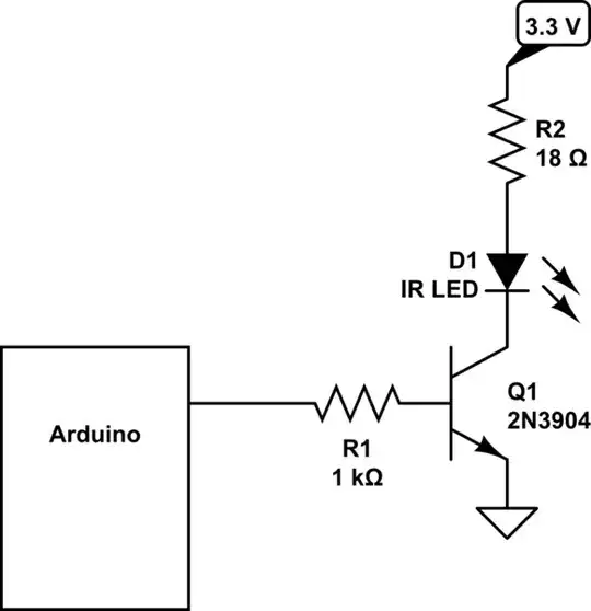

With 3.3 Volt Vcc, the Atmel ATMega328's recommended output current seems to be 10 mA or so, so you can't drive the IR LED directly from an I/O pin. Instead you will have to do something like:
schematic
The 18 ohm resistor should limit the LED current to about 80 mA - safely under its maximum rating of 100 mA. 20 or 22 ohms would reduce the current a bit more, if you want to be safer.
The transistor's emitter must be connected to the Arduino ground.

    Hm, since you want to drive the LED at 80 mA and you want to saturate Q1, R1=1kOhm is too high. I arrive at R1 = (2.6 V - 0.9 V) / 0.008 A = 212.5 Ohm. Note that an ATmega328p output pin drops voltage with higher current, thus I'm using 2.6 V instead of 3.3 V (cf. datasheet). And 0.9 V is the voltage drop at the Q1 base (cf. V_BE(sat) in a 2N3903 datasheet). Assuming that Q1 saturates at I_C / I_B = 10, as specified in the datasheet. For R2 I arrive at R2 = (3.3 V - 1.5 V - 0.3 V) / 0.08 = 18.7 which is what you already have in your schematic. (i.e. V_CE(sat)=0.3 V, V_F_LED=1.5 V) – maxschlepzig Feb 20 '22 at 16:15
