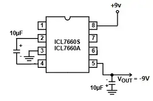

You can use the ICL7660. It takes a positive voltage (up to 12v) and generates the inverse:
Very easy to use, I've used it in several commercial products.

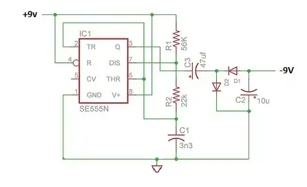

If the ICL7660 chip is difficult to find, you can also roll your own" charge pump inverter" using a 555 timer, which should be available anywhere, and a few extra components:
There are lots of variations on this circuit, not just for generating negative voltages but also voltage doublers and triplers too. Just do a Google search for "555 charge pump images".

  • LT1054 is a pin compatible replacement for the ICL7660. Might be easier to find. – Nils Pipenbrinck Mar 29 '15 at 07:28
  • what is the value for C1, D1 and D2? – user16307 Apr 01 '15 at 13:41
  • The diodes will be general purpose signal diodes, 1N4148. There is a value shown for C1, 3n3. I'm going to take that to be 3.3 nF, which is the same as 3300 pF and 0.0033 µF. Those are all the same value, just different suffixes. This is going to be setting the switching frequency, so it is not too critical. Having said that, it seems sort of low to me. If the circuit doesn't work as expected, you should try larger values. Not going to hurt anything. Remember, there are also plenty of other 555 positive to negative circuit in that search I mentioned. – tcrosley Apr 01 '15 at 19:34
