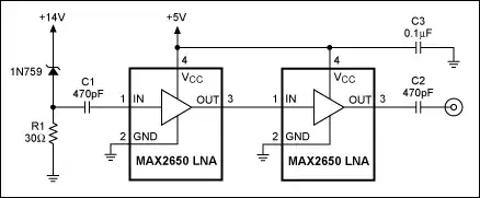

The randomising diode is perfect for amateur and professional low rate random number generation. It's junction breaks down when reverse biased and creates totally unpredictable electrical noise. You can then process this entropy to extract random numbers. Maxim have a good application circuit based around a 1N759 Zener diode. Here's an extract:-
TRNG circuit
They've measured noise out to 100 MHz. If this were to be sampled at say 4 bits via a flash ADC, you might expect random numbers in the order of 100 Mbits /s. This is very much an upper limit as I've never seen a commercial diode based TRNG anywhere this speed. I'm quite chuffed to achieve 100 kbits /s.

    Is this how one decouples a 100 MHz circuit, by sharing a capacitor? – Paul Uszak Mar 08 '17 at 23:30
