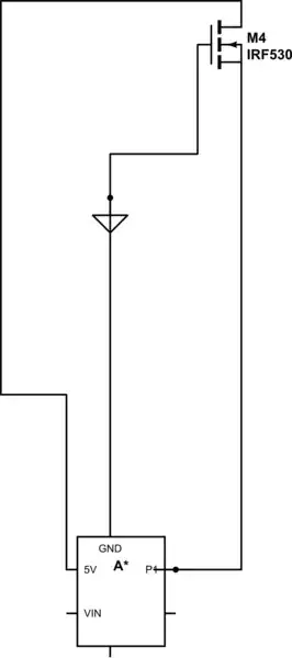

Attempt at drawing out configuration in first video, where the A* microcontroller is getting 5V of power from its usb plug:
schematic

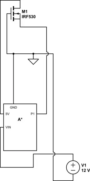

Attempt at drawing schematic of video 2
schematic

Attempted schematic for a new 3rd video, trying to power the relay separately.
schematic

  • ok i tried to add some schematics. I'm not sure if I'm using the right symbol for that relay module... – tmsimont Mar 24 '15 at 21:12

  • I just tried this and it still has the same result. I added a 3rd video and an attempt to draw this out in a schematic. Is this third video I have what you describe I should do? – tmsimont Mar 24 '15 at 21:13
