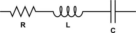

To give some context, you can run into this scenario when finding the impedance of a capacitor using a series R,L,C model.
schematic
$$\hat{Z} = R + j\omega L + \frac{1}{j\omega C}$$
$$\hat{Z} = \frac{j\omega RC - \omega^2LC + 1}{j\omega C}$$
If you treat \$\omega\$ as your input variable and \$\hat{Z}\$ as your output variable, then the complex impedance can be seen as a transfer function. For the equation shown, can you put this into the pole-zero format?

As a function of \$s\$ you get for the impedance
$$Z(s)=R+sL+\frac{1}{sC}=\frac{s^2LC+RCs+1}{sC}=L\frac{s^2+\frac{R}{L}s+\frac{1}{LC}}{s}\tag{1}$$
Computing the zeros of the numerator of (1) gives
$$z_{1,2}=-\frac{R}{2L}\pm\sqrt{\frac{R^2}{4L^2}-\frac{1}{LC}}\tag{2}$$
With these zeros, the impedance (1) can be written as
$$Z(s)=L\frac{(s-z_1)(s-z_2)}{s}\tag{3}$$
From (3) it is clear that apart from the two zeros at \$s=z_1\$ and \$s=z_2\$ we have two poles at \$s=0\$ and \$s\rightarrow\infty\$, which makes sense because for DC the impedance becomes infinite due to the capacitor, and for \$\omega\rightarrow\infty\$ the impedance goes to infinity due to the inductor.
