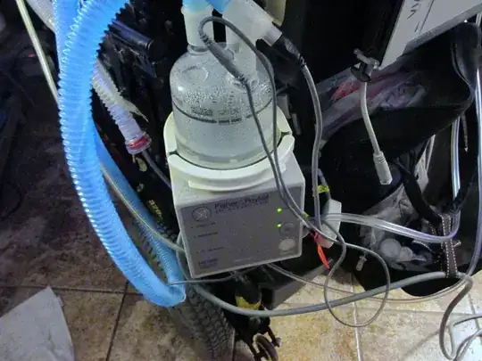

I am an absolute novice in regards to electrical engineering, and so I am hopeful your expertise can guide me in the right direction. I know this is an unusual post for this forum, and so I thank you in advance for your consideration.
First, let me provide some context to my question. I am a quadriplegic, and I use a ventilator to support my breathing. The ventilator setup includes a humidifier to keep my lungs moist. In my particular situation, I'm unable to be without humidification for any significant period of time. I do use a heated wire with the humidifier which decreases condensation in the ventilator tubing. Both the ventilator and humidifier are attached to my wheelchair, and each has its own power cords. The ventilator also has its own battery component, but the humidifier does not. As you might imagine, needing to be connected to a power outlet greatly limits my mobility.
Given all of that, I would love to be able to power my humidifier with some type of battery pack - although I don't know how or if it's possible. With the advances in battery technology, I'd like to think it's possible. My initial idea was to tie into the batteries that power my wheelchair, but the people who service my chair told me those batteries would be depleted quickly from the humidifier.
Here are the electrical specifications for the humidifier, along with a couple of other pictures:
humidifier electrical specification
Humidifier 1
Humidifier 2
So, I guess I have several questions. Where would you begin if you needed to resolve this problem? What capacity battery would I need in order to run the humidifier for several hours? Is such a battery readily available or would it need to be designed specifically for this purpose? Could the connection be grounded? Is there any other issues that I might be overlooking?
I would be very grateful for any knowledge you could share with me.
Many thanks, David

    That's not a trivial amount of power. You're going to need tens of kilograms of battery to run it for several hours. – Ignacio Vazquez-Abrams Mar 17 '15 at 19:50
  • You would need to attach or pull around on a trolley a car battery or two and an AC inverter (to convert DC battery voltage to the 115V AC) to power the unit. – KyranF Mar 17 '15 at 20:11
  • There are some commercial battery or rechargeable products out there that would probably be cheaper. – Passerby Mar 17 '15 at 20:24
  • I looked at the HC500 manual, and it's clear that electrical efficiency was not a high priority in its design. Ease of use, and minimizing the possibility of contamination/infection are obviously much more important. That said, have you searched for alternative units that might have lower power requirements? – Dave Tweed Mar 17 '15 at 20:26
    Just running the numbers, if you needed 10 l/min. of air at 40 mg/l absolute humidity, and given that the heat of vaporization for water is about 2260 J/g, that means that you'd need about 15 W of heat delivered to the water. The trick to getting good efficiency will be to minimize the heat that is lost to the environment. – Dave Tweed Mar 17 '15 at 20:42

The basic problem is that this humidifier needs a lot of power. It needs 184 W worst case from the specs you provided, so let's say 210 W into a inverter. Let's say it has to sustain this for 2 hours, so that's 1.5 MJ. So far this is all just basic physics, nothing clever electronics can get around.
Let's put the 1.5 MJ figure in perspective of a car battery. 210 W at 12 V requires 17.5 A. For two hours, that's 35 Ah, but you can't drain such a battery all the way down without damaging it. In car battery terms, you'd need one rated to 50 Ah at least. That's not going to be small or light.
Today there are other battery technologies that are both smaller and lighter for the same energy storage. For example, the 20 Ah 3.3 V prismatic lithium cells from A123 are about 500 g each. (210 W)/(3 V) = 70 A total, so four 20 Ah cells can in theory handle this for one hour. However, this needs to be derated for various reasons, so figure 5 cells at least for one hour duration, so 10 for two hours. That's 5 kg or 11 pounds, although that doesn't count the inverter, the charger, and the mechanics to hold it all.
So, yes, it could be done at significant expense, would take significant space and weight, and cost a great deal. A better answer is to spend the money instead on a better humidifier, one that was designed for efficiency and battery backup use. I haven't looked what is out there like that, but that's where I'd start.
