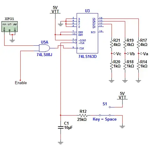

I built a circuit that uses the 74LS163 synchronous counter. I am using in such a way that I reset the counter, using the /clear input pin, externally via and LPF connected to a tactile switch.

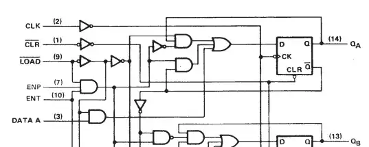

The design works fine, except that I am getting a strange output voltage from the clear pin. A block diagram presented in the datasheet for this pin is:
So, clearly the clear pin is an input to a gate, so how could a constant voltage appear at this terminal? Specifically, I am observing a ~1.41V on this terminal when it is left floating, and 1.11V when connected to the LPF with the switch fully depressed. I thought perhaps there was some excess charge at the transistor base, so I directly tied the clear pin to ground to discharge it. Upon removing this pin from ground the ~1.41V returned immediately.
The schematic I have wired is as follows: enter image description here
When the switch is fully depressed, the capacitor will only discharge down to 1.11V. If I disconnect the clear pin from the capacitor anode then the capacitor will fully discharge to 0V as expected, so something is going on here that I cannot explain. I tried replacing the '163 with different physical device to rule out a malfunctioning chip, but the device I replaced it with also exhibited this behavior.

Inputs of bipolar TTL (74xx, 74LSxx, and others without a "C" in the middle) parts source current, so require a fairly low resistance to ground to be recognized as a low.
You may need to draw up to 0.8 mA from the Clear input pin (and most others) to get the pin below 0.4 volts, so it will recognized as a Low.
CMOS versions (74 AC, 74HC, etc) have very high impedance inputs, and should work with your Clear circuit, if you add a 100K pull-up resistor, although I'd use a 10 K pull-up, and reduce R12 to 1K or so.

This behavior is both correct and expected. The input stage of a TTL device acts as a current source, so some voltage will always be present except on a short to ground.
R12 should tie the input to Vcc, and there should be no (or at least a much smaller) resistance in series with the swtich.
