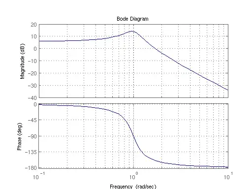

Most Bode plots look like this: enter image description here
I honestly have to say I am not in the least impressed by this plot. All that the Bode plot is telling me is that as frequency go up, at frequency of 1 Hz, there is a peak in system response, then it goes down afterwards (surprise surprise). The phase is a bit more enigmatic, it seems to tell me that the signal experiences a larger delay as frequency goes up.
What are some conclusions that an experienced engineer is able to see from looking at these Bode plots. Are there things that are not obvious that is blocking me from seeing the utility of these bodes plots?

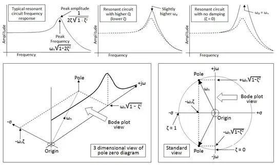

The bode plot is a representation of the bigger picture. That bigger picture is the pole zero diagram: -
The top three images (all bode plots) give you different examples of a 2nd order low pass filter. The bottom left picture shows you the bigger picture - it combines the bode plot with the pole zero diagram i.e it's 3D. Bottom right is the view of the 3D image looking down from above - this is the pole zero diagram I mentioned and this contains all the mathematical information for a system or filter.
The bode plot is a simplification of the pole zero diagram but, importantly it shows you directly the response of a filter (or system) in terms of amplitude and frequency (jw).

From your Bode plot (or 'frequency response' is probably a more descriptive term), just by cursory inspection it can be seen that: the system is 2nd order (since the high frequency roll-off is 40dB/decade); underdamped (since it has a resonance peak); probably has natural frequency of 1rad/sec (since the resonance peak is a little lower than 1 rad/sec); Has a DC gain of about 6dB (equivalent to a 'straight' gain of about 2); the resonance peak is about 7 or 8dB above the DC level, hence the damping coefficient is between 0.1 and 0.2, say 0.15, so the system is lightly damped; and the bandwidth is about 1.2rad/sec.
Thus, an estimate of the closed transfer function is:
$$G(s) = \frac{2}{s^2 + 0.3s +1}$$
From this transfer function you can determine the time domain response to any deterministic input signal, such as impulse, step, ramp which, along with the frequency response, gives a lot of insight into the performance of the system in the real world.

  • You could also get two poles from the 180 degree phase lag at high frequency, and the shape suggests no zeros, or at least uncancelled zeros (as nothing adds 20 dB/decade of slope anywhere) – Scott Seidman Mar 16 '15 at 21:25
