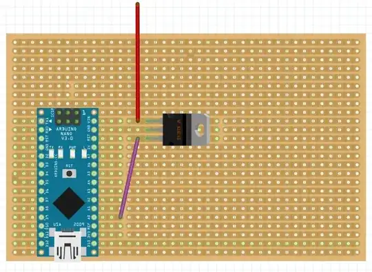

Fritzing looks like the ideal tool for this:
  • Free (GPL license)
  • Multi platform (Linux, Mac OS, Windows)
  • Integrates a large library of components
The stripboard can be resized, you can chose the strips to be vertical or horizontal. You can also cut the contacts with your mouse like you would do in real life.
Example circuit: Fritzing simple stripboard Arduino circuit

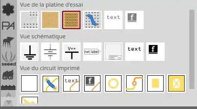

Edit 30/10/2018: Make sure you add a Stripboard and not a Perfboard, the Stripboard is the one circled by the dark red square on the following screenshot: (third item on the first row)
Add Stripboard image

  • This is absolutely the best!!! – Antonio Petricca May 02 '17 at 12:16
  • Victor, how did you get that copper PCB board to show on your fritzing tool? Mine is just a gray background with no holes. – WhiskerBiscuit Oct 29 '18 at 17:37
  • @WhiskerBiscuit I have tested again with Fritzing 0.9.3b on Kubuntu 18.04. Make sure you add a Stripboard and not a Perfboard (they are right next to each other, the Stripboard is the one on the right). – Victor Lamoine Oct 30 '18 at 08:57
    Fritzing is a nice software, but useless for perfboards. It does not even let you flip the board over to plan out the routes, which is kind of THE feature you need to perfboards... – Daniele Testa Nov 12 '18 at 09:12
  • How do I show the perfboard so that I can see where under the Arduino the strips are drilled? – Thomas Weller Nov 13 '18 at 20:53
  • How do I find components that are designed from top view? E.g. your voltage regulator takes too much space. It wastes 7*3 holes. – Thomas Weller Nov 13 '18 at 20:55

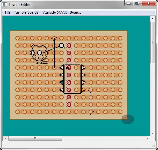

Soft Circuit Editor by Atarado here.
  • Free (as in zero purchase price)
  • Windows and Linux
  • Two-windows - schematic and layout.
  • Supports normal stripboard
  • Supports Atarado's proprietary stripboard layouts.
  • Very limited component library?

  • I edited the Answer to include some details of the product. I downloaded SCE to make a screenshot (to avoid stepping on copyright toes) and found there's no user documentation and I can't work out how to delete, move or rotate components. – RedGrittyBrick Jan 17 '14 at 11:38
  • Doubleclick on component rotate it clocwise, shift+2click ccw; that's for schematic, and for layouts non-stretching components. Stretching components in layout, click on pin and drag...There is lot of hidden features with ctrl+alt+shift combinations with clicking or doubleclicking...right mouse click....click on empty area...drag... – Alex Jan 31 '14 at 12:36

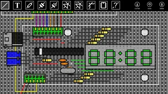

There's a nice free Windows 8.1 app for designing stripboard/perfboard/breadboard called DrawingBoard Pro available from the Windows Store.
DrawingBoard Pro screenshot
