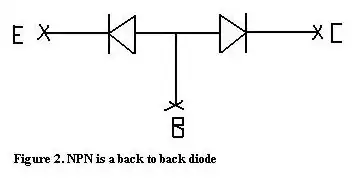

What I can't seem to find is the reasoning behind the naming, as in why they are named that way. I have a feeling it has something to do w/ the diode model of the BJT:
and I know the basic operation of the diode, but can't make sense of this for some reason, and can't seem to find it on the 'net.

    Unfortunately, that diode 'model' is not useful (perhaps actually harmful). It does not resemble what an actual BJT does in any mode except cutoff. Maybe try (re)reading the Wikipedia article the above table was lifted out of? – Spehro Pefhany Mar 10 '15 at 01:18
