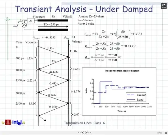

Chances are slim that the lamp, as a load exactly matches the voltage and current arriving at it but, if it does then all is well and there are no reflections back up the cable. Here is a picture of what happens: -
You have to get to grips with the concept of reflection and reflection coefficients to understand this properly. Here is a really nice tutorial that takes you through the steps and where I stole the diagram from. It starts at the below type of level so hopefully it'll be enough to get you started.
