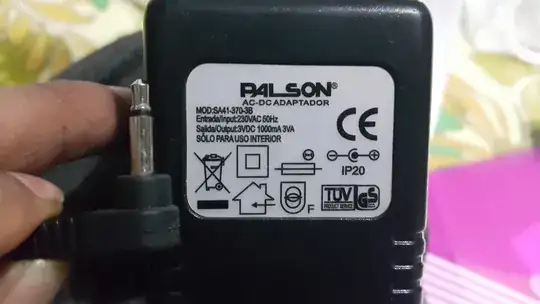

So I looked around and found an adapter at home which says: Output:3VDC 1000mA 3VA. I actually have no clue what that means but I'm guessing that it will output the 3V required to run the auto feeder.
Bought a multimeter and used it to measure the output of the adapter. I was expecting to see 3.00.
Nope. I'm getting a reading of 6.46 every time.
So this is my question - is it OK to go ahead and wire the adapter to the fish feeder despite the higher reading? Will everything magically work or something is sure to blow up? Will adding some register help? I would've gone ahead to find out if the feeder was available in my Country. I imported it from the US so I don't want to mess it up.
Could you guys please give me advice on how I can accomplish what I'm trying to do? I'm totally ok to start from scratch.
EDIT: As for the adapter, it's from an electric shaver and this is how it looks: the adapter

Judging from the picture that you posted:
DC Adapter
You have an unregulated DC adapter. See this link for some more details.
In simple terms, the amount of voltage that your adapter puts out goes down as the amount of current draw goes up. In your case, the adapter is rated for 3 VDC at 1000 mA, so it will put out:
  • 3 V when you draw 1000 mA
  • < 3 V when you draw more than 1000 mA
  • 3 V when you draw less than 1000 mA (as you've measured, 6.46 V at 0 mA)
Since I don't know anything about your fish feeder, I don't know how much current it'll take or how much voltage is safe to put on it. It might work. It might not. If you can get your hands on a regulated 3 V adapter, you and your fish would be much happier.
