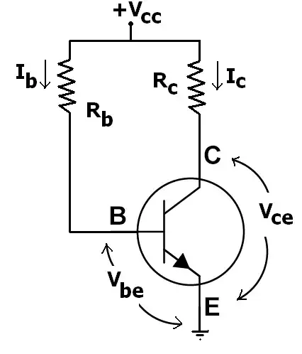

It is possible. Consider the figure below.
The collector current at saturation will be $$I_{Csat} = \frac{V_{CC}-V_{CEsat}}{R_C} \approx \frac{V_{CC}}{R_C}$$
The base current is given by, $$I_B = \frac{V_{CC} - V_{BE}}{R_B} \approx \frac{V_{CC}}{R_B}$$
So it is clear that the currents at saturation are entirely decided by the resistors and hence base current can be greater than the collector current at saturation.
