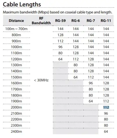

You want an Ethernet over coax extender like this one...
https://www.amazon.com/StarTech-com-Gigabit-Ethernet-Unmanaged-Extender/dp/B00AMCKN80/ref=as_sl_pc_ss_til?tag=joshcom-20&linkCode=w01&linkId=B6C47PTXNGHWHVUT&creativeASIN=B00AMCKN80
It should easily be able get you to 100Mbps @ 2000ft (~600 meters) using any supported coax cable...

  • The speed depends on range and cable quality. If you have room in the conduit, you should be able to get 112Mbps @ 2000 feet over RG-11 cable. The length/speed/distance chart for the coax model is available at http://sgcdn.startech.com/005329/media/sets/EOC1110x_Manual/EOC1110x.pdf. – bigjosh Feb 19 '15 at 16:59
  • I like the idea of the coax-based solution. 1) coax is cheap! 2) I can fit multiple RG6 cables in my 1/2" conduit 3) 144Mbps at ~600m with RG6 looks well within spec. 4) the extender hardware seems reasonably priced. THANKS! – Ryan Griggs Feb 19 '15 at 17:36
