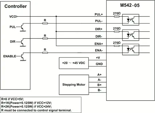

I have been looking over various data sheets for hours and still am not sure how to select an apporiate device. I am looking to send 5V 10mA pulses at 100-300kHz (to be determined) to a motor driver from my beaglebone 3.3V outputs. My plan is to use an N-channel MOSFET in this configuration:
http://www.americanmotiontech.com/Upload/DriveConnection/M542-05.gif Where Vcc will be connected to the 5V line from Beaglebone and the gates connected to the GPIOs with internal pull-downs enabled.

    You say you want to "use an N-channel mosfet", but your schematic doesn't include any n-channel MOSFETs. – The Photon Feb 15 '15 at 17:51
    What you want is a level translator. You should probably only use an optocoupler if you also need galvanic isolation or need to break a ground loop---otherwise you're taking on extra cost and performance limitations for no reason. – The Photon Feb 15 '15 at 17:57
  • That schematic is from the motor driver manual. The opto couplers are inside the drivers. Is there any problem with putting N channel mosfets where the transistors shown are, with the drain'sto the (-) of the the driver'sm source's to ground and gate's to my beagleboen GPIO's for toggling. –  Feb 15 '15 at 18:06
  • That should work, but it's likely easier to find a BJT than a MOSFET to drive the opto with 3.3 V input. Note your FET datasheet defines threshold voltage with Vds = Vgs. That means the FET drain will possibly still be at 3 V when you have it switched "on". Or it could be substantially lower. Which might make it hard to choose a current-limit resistor for the opto input. – The Photon Feb 15 '15 at 18:35

  • I have no idea about the transfer rate, but the driver manual says logic HIGH is 4-5V, 7mA minumum with 1.5us or greater pulse width. My goal is to actually control three of motors. I hooked one up in the configuration posted above with a 2n3904 and the VDD 5v begalebone pin supplying the Vcc, I was only able to get the motor spinning with a pulse width of 150us or greater (using the PRU's). I don't have a scope so I am not sure what the waveform actually looked like. These line buffers look pretty simple to use, are they more desirable for my application? –  Feb 16 '15 at 08:50

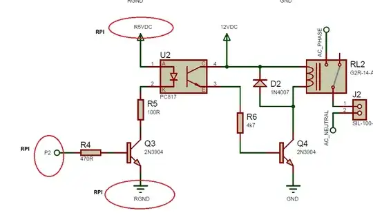

I am using a circuit for RPI as follows: enter image description here
But this is not very fast(Not required in this case).
Note: Personally I dont have any Optocoupler that can handle 300Khz signal, still this might help you.
