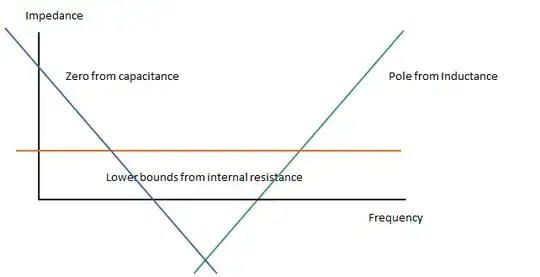

As stated in both the forum post and the app note the physical geometry of a capacitor dictates the self-inductance. In the case of decoupling the capacitor can be modeled as a small power supply with internal resistance, inductance and capacitance. In the frequency domain the view of the internal impedance of the capacitor is a "trough" where the beginning (zero) of the trough is dictated by the capacitance value and the end (pole) is from the parasitic-inductance. The lowest point of the trough is set by either the parasitic resistance or the lowest value of the resonance frequency of the LC combination of the capacitor / parasitic inductance value (whichever produces a higher impedance).
The following is an image illustrating the characteristics of a capacitor
here is the equation for the resonance frequency. $$ \frac{1}{2\pi \sqrt{L \times C}} $$ -Thanks for catching that Olin
By this reasoning one can choose the largest size capacitor in the given package size, for example 0402, and the properties of the pole will not change and only the zero will be moved to a lower frequency (in the image, the downward slope would be moved to the left for large capacitor values) allowing a wider bandwidths of frequency to be bypassed. The resonant pole that defines the upper portion of the capacitor should encompass any higher value capacitor of the same package size.

Since the package size is the part of the cap that mitigates the pole or the upper bound of the impedance of the modeled power supply, then it shouldn't matter if I were to use a 0.001uF cap 0402 package, or a 0.47uF capacitor 0402 package. A better method to determine the Fris of the cap is to find the frequency at which either the internal resistance or the effective capacitance intersects with the pole (whichever point is higher). Is this correct? or is there some other factor that I have not taken into consideration?

    Your calculation of resonant frequency is missing a square root. It should be F = 1 / (2 Pi sqrt(L C)). – Olin Lathrop Jun 13 '11 at 16:20
  • Size is important. The 1nF cap may not hold enough energy to bridge the dip. You'll have to know what kind of current causes the dip and its duration. – stevenvh Jun 13 '11 at 16:20
  • @Olin Lathrop. Woops thanks! Well reputation beats me again, can't edit the post without 10... if I ever get there, I'll fix it. – Dave Jun 13 '11 at 17:04
  • @Dave: "an accepted effective response time of a capacitor is 1/40th of the resonance period", but then you divide the frequency by 40. Dividing the period = multiplying frequency. – Federico Russo Jun 13 '11 at 17:19

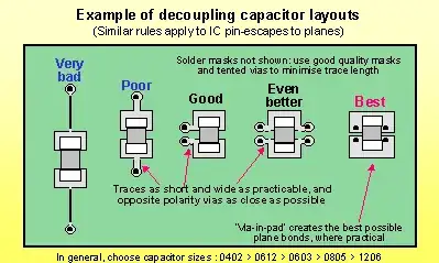

The ideal would be to use lots of 0.1 uF caps in an 0402 package. Place them under the chip on the back side of the PCB. The cap be routed as in the image below. And the vias go directly to the power/ground planes (not to the chip's power pins, as that would usually increase the inductance). If you place the cap under the chip then sometimes you could share the same via without any issues.
proper decoupling cap layout
The reason why a 0.1 uF cap was chosen is because it is the highest practical in an 0402 package. The reason why 0402 was chosen is because it is the smallest practical size, and you want to use a lot of them to get the effective ESL/ESR down. Of course all bets are off if you have a 2 layer PCB without power and ground planes.

  • Bypass caps serve to both minimize local dips in VDD-VSS, and also to minimize surges in main supply current. Provided VDD-VSS doesn't dip so much as to cause problems, further reductions in supply current surges are apt to be more useful than reductions in VDD-VSS dips (since the former causes EMI). I would expect that having the bypass cap between the ground plane and the chip's supply leads would be optimal for EMI reduction; would you agree with that? – supercat Jun 13 '11 at 23:00
  • @supercat I didn't follow completely. Caps directly on the power/gnd pins will reduce power related EMI, but increase EMI due to the increased loop area of signals plus their return path. If I have to choose between caps on the pins or caps w/vias to the planes I'd go with vias to the planes. If you put caps on the back side of the PCB then it's possible to have your cake and eat it too. If I can't do that then I'd do as much "creative routing" as possible to do both-- essentially compromise, probably by having more caps and putting them everywhere I can fit one. –  Jun 13 '11 at 23:58
  • @David Kessner: My thought would be that if the cap is between the supply and the chip, then the dI/dt of the supply will be limited by the amount which the bypass cap voltage sags. Otherwise if e.g. the inductance between the pins and the supply is 10x that of the inductance between the pins and the cap, then 10% of any current spike will be transmitted through to the supply. Is my thinking in error? – supercat Jun 14 '11 at 02:06
  • @supercat Think about the inductance of the power supply cable and the bulk capacitance on the PCB and in the supply. This is going to form a rather large LC filter with a relatively low cutoff freq. Were it not for this LC filter, then what you are suggesting might be true. However, if it were true then I would suggest that the bulk caps (and maybe the input power filter) where the power goes into the PCB was not done correctly. A small difference in the placement of a 0.1 uF cap shouldn't matter to the power supply in a properly designed system. –  Jun 14 '11 at 02:27
