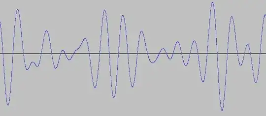

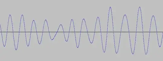

For example, here is random noise filtered to contain only frequencies between 190 Hz and 210 Hz:
Observe that it is not that far off from a (200 Hz) sinewave. For comparison, here's noise filtered to contain 150 Hz to 250 Hz:
Note how it differs much more from a perfect sinewave. Now, if you take a 24 GHz sinewave and start arbitrarily turning bits of it on and off, the receiver will not see it the way you send it, because turning bits on/off arbitrarily will make the signal fall outside of the 24 GHz range. The receiver will filter out frequencies outside the 24 GHz range, thus distorting the signal. Bottom line is: if you modulate the signal naively by turning bits on and off, it won't work with the idea of filtering out unwanted frequencies.

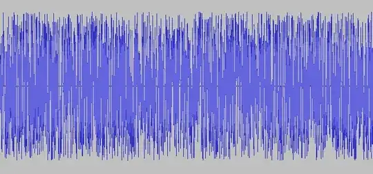

Before filtering, the above signal looked like this:
Think of it as what a radio receiver sees before it filters out unwanted frequencies. I think that's a reasonable layman approximation. Note that the horizontal scale here is exactly the same as in the images above – what you're seeing are all the frequencies higher than 200-odd Hz. Frequencies below 200 Hz are also there, but they are not obvious to the naked eye.
