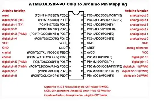

I think the title is self-explanatory but should I make the connection on PCB or they are already connected? If so, should I still connect them externally? Why?
I'm working on ATMEGA328p-pu if it matters.
(source: instructables.com)
No, there is no internal connection. One ground is Digital ground, the other Analog Ground, and they should be connected through an inductor capacitor circuit for best performance. I know this is a dupe of a Avr specific question I answered too
