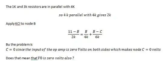

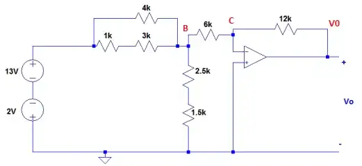

I was wondering what would be the voltage of the node which is connected to 1K and 4K resistors? sometimes I think I need to add up the two voltage sources( 13-2=11V) but I wonder maybe it is just 13V . can you give me some insights please? I am really carious to know when can we add up and when we cannot? what if the polarity of 2V source was the other way around? ( I think then that would 13+2=15V).
The main goal is to find V0 here is what I have tried so far. I would appreciate your comments on that.

  • It's 11V. You reference it to ground, and from ground you have +13 and -2V so +11V total. The 13V is a power source, not a node measurement; you can't just ignore the 2V source. – I. Wolfe Feb 03 '15 at 22:45
  • then what would be V0( negative polarity) ? zero because it is connected to the ground? – user65652 Feb 03 '15 at 22:47
  • I am lot here, so the ground is 2 V ? – user65652 Feb 03 '15 at 22:48
  • Vo is the voltage from the + to the minus. So it is the voltage of the + side in reference to ground. – I. Wolfe Feb 03 '15 at 22:49
  • Ground is just a reference point, it is the point we take as being 0V. The 2V source is a negative source in reference to ground. So it outputs -2V into the circuit. Just think of ground this way: How do you know 2V is 2V? You know because it is 2V higher than ground. – I. Wolfe Feb 03 '15 at 22:52
  • can I assume that positive polarity of the Op Amp is zero since it is connected to the ground ? – user65652 Feb 03 '15 at 22:58
  • Please label the nodes of your circuit so you can say "node A" instead of "the node which is connected to 1K and 4K resistors". – The Photon Feb 03 '15 at 23:03
  • And yes, things that are connected by ideal wires are at the same potential, and the potential of the ground node is, by definition, 0 V. – The Photon Feb 03 '15 at 23:04
  • I did my analysis and I came up with V0=0V, is that correct? – user65652 Feb 03 '15 at 23:06

  • I modified the question, please have a look at it and let me know, thanks – user65652 Feb 03 '15 at 23:25
    Think about where the current through the 6k resistor goes. Apply KCL to node C – Scott Seidman Feb 03 '15 at 23:42
  • one the one hand, we know that current going through the op amp is zero, also the input of op ampt is zero which makes Node zero to be 0 zero, but still current going through to the output of op amp through 12 ohm resistor, it is so weird, why is that ? – user65652 Feb 03 '15 at 23:45
  • Again, FORMALLY apply KCL to node C -- work through the equation you get, and tell us the current going through the 12K resistor. – Scott Seidman Feb 04 '15 at 00:02
  • I found V0=-12 V – user65652 Feb 04 '15 at 00:07
  • Now you're talking! If point B is really 6 volts, which I didn't check, then Vout would be -12 volts, as the output stage is an inverting amp with a gain of -2. – Scott Seidman Feb 04 '15 at 01:52
When two two-terminal elements are in series, the voltage across the combination is equal to the sum of the voltages of the branches.
When two two-terminal elements are in parallel, the total current through the combination is equal to the sum of the currents of the two branches.
But the problem is C=0 since the input of the op-amp is zero volts on both sides, ... does that mean V0 is zero volts also?
We say that negative feedback drives node C to zero, but what we really mean is just that it drives it really close to zero. Since C is close to zero but not exactly zero, and the gain of the op-amp is really large (like 100,000 or 1,000,000) then V0 isn't exactly zero.
Having calculated the output voltage as -12 V, and assuming the gain is 100,000 (just a typical number, check the datasheet of your op-amp for an appropriate value for your device), you can see that node C is really at about 0.12 mV. You can see that this value doesn't appreciably change the analysis of the input circuit (and in fact this value could be totally inaccurate due to other op-amp non-idealities like input offset voltage).
If you really want to know how big this effect is, the easiest way is to simulate your circuit with a non-ideal op-amp model in a SPICE-like simulator.

    Well, since node A is at 11 V, then node B must be somewhere between 0 and 11 V. Then the current through R5 must be positive. And that means, for negative feedback to work, current through R6 must be positive. And that means Vo < 0. (You see how much easier this would be if you labeled your nodes and components? Then I would have used your names instead of just making some up and you'd know what I'm talking about) – The Photon Feb 03 '15 at 23:10

The output calculates to -12V. Thevinize the - input which is at 0 volts, assuming the Av of the opamp is large. That turns the junction point "B" into 6V as "C" is almost 0.00V.
Wow! Cut and paste doesn't work here. No MathCAD for you!
6K*4K/(6K+4K)=2.4K resistance to ground at "B"
Thevinizing: 2.4K*11V/(2K+2.4K)= 6V with 6K series resistance (Point "B" to - in)
(12K/6K*)-1 = -12V . Guess you could use Norton, or worse Thevinin (N+1) but why?

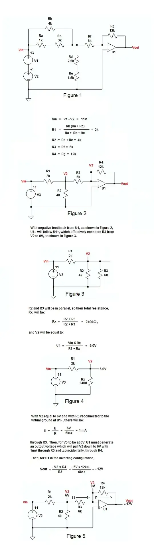

One picture is worth a thousand words:

  • Just a small correction: In Fig. 5 we have R2=4k (instead of 2k); nice calculation. – LvW Feb 04 '15 at 09:50
  • thanks a lot, even though I finished it myself, but it is good to see someone else's solutions. – user65652 Feb 04 '15 at 13:36
