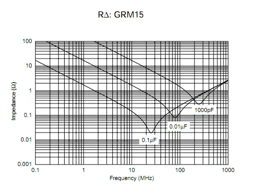

Inductance... Followed by impedance. Your caps are trying to provide a low impedance path for current to flow at your frequency of interest. One culprit will likely be how you connected your caps, and the second will be their impedance over frequency.
Look for this curve in the datasheets of both parts. enter image description here
You'll see how much lower the impedance of the other groups caps will be at higher frequency (where your device probably needs it).
Not to say electrolytics are not useful in a power distribution network design, they're just only really useful at low frequency. The added inductance of the package doesn't help.
