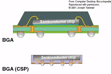

Formally, to be qualified as a CSP the package must be not greater than 120% of the die area. BGAs are usually greater than 120% of the die area and thus usually do not qualify as CSP.
Appendix
1) Flip chip is an example of CSP. However, not every CSP is a flip chip (e.g. lead-frame based CSP).
2) To the best of my knowledge, wire bonding is used extensively in BGAs: most of pins are connected with wire bonds. In CSP majority of pins are directly connected to the board with solder bumps or lead-frame.

Pic. 2: Typical BGA, flip chip and CSP structures. Source URL
