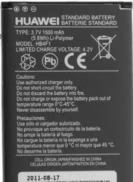

I am trying to determine the shelf life of a typical Li-Polymer battery. I have Googled but can't find any definitive view on the matter.
There are two questions regarding the battery shown: 1. What is the likely useful shelf life of an unused (from factory) battery 2. Referring to the image, clearly we have + and -, but what might the T terminal be for. The voltage between +/T and also +/- is the same at 3.78v.
Many thanks
Battery markings

Li-Poly batteries have a useful voltage range of 3.0v to 4.2v --under 3.0v they are effectively discharged, and 4.2v they are fully charged. Both the protection circuit in the battery itself and the special L-Poly charger chips limit the high-end voltage (since going above this value can cause the battery to vent and catch fire).
Contrary to popular belief, it is not best to charge the chip to the maximum voltage of 4.2v before putting it in storage; rather a voltage of around 50% of full charge (3.6 to 3.7v) is preferred. This is borne out in the table in Andreas' answer. 3.7v is also the typical voltage the battery is charged to when it leaves the factory, and is considered the nominal working voltage for the battery as well.
In my own work, the company I am contracting at has had over a thousand cells in storage at room temperature for 18 months to over two years without any issues, with only a slight voltage drop. I realize that is anecdotal evidence.
The important thing is before using any Li-Poly cells that have been in storage is to measure their voltage before being hooked up to a charger. If they have dipped below 3v (or show no voltage at all, because the battery's internal discharge protection circuit has kicked in), I would safely get rid of them -- they are damaged goods. (Some would argue that has long as they haven't tripped the battery's low limit, which might be 2.5v, they can still be rescued.) And of course if a battery shows any signs of expansion (starting to look like a little pillow), out it goes.

For LiPo cells you can not strictly speak of a shelf-life, since they basically start aging the moment the batteries are assembled.
Aging depends greatly on the state of charge and storage temperature. The more they are charged, the faster they age. On the other side they are damaged if they are every discharged below a certain point they are unusable and can not be safely charged anymore (consumer device batteries prevent damage in that case by e.g. monitoring the cell temperature)
One table I could find online (at batteryuniversity.com) is sadly for LiIon cells, but LiPo cells should fare similar. It shows capacity loss vs. storage temperature and state of charge:
Storage Temperature  |      40% charged     |   100% charged
      0°C            |    2% after 1 year   |  6% after 1 year
     25°C            |    4% after 1 year   | 20% after 1 year
     40°C            |   15% after 1 year   | 35% after 1 year
     60°C            |   25% after 1 year   | 40% after 3 months
The thing that makes matters worse is that cells have self-discharge, and normal consumer device batteries have protection circuits embedded in them which consume a small amount of current even if the battery is not being used. So even if you made sure to store all your batteries at e.g. 40% charge, they will not stay at those 40% and slowly drift towards deeply discharged or unusable.
So sadly it's not as easy as to say that such cell have a shelf live of e.g. x years.
