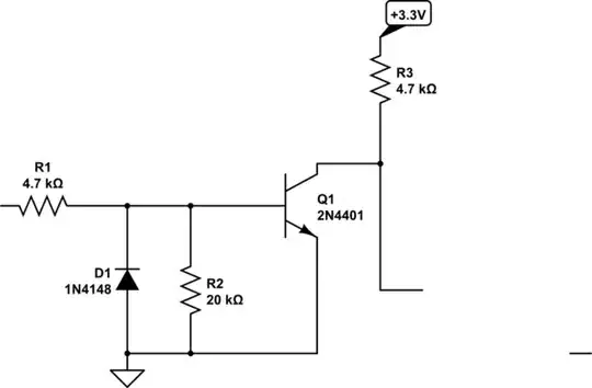

If you don't mind the signal being inverted, something like the below would be very robust. Even transients of +/-60V on the input won't harm anything, nor will a continuous short to +13.8V.
schematic
