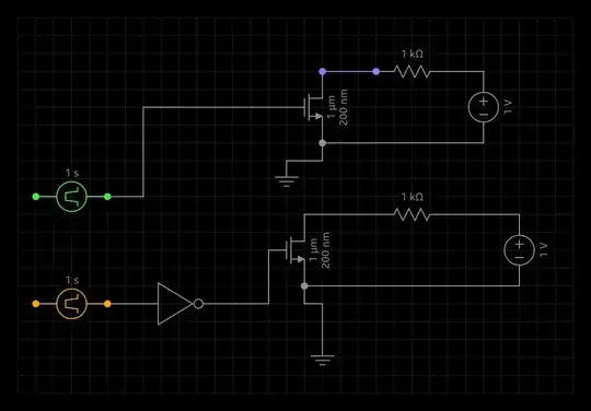

My intent is to make sure that when the top mosfet is on the bottom mosfet is off and vice versa. I'm really not sure that this accomplishes the goal. Is there some better way than this? I'm using two current sources that are configured to one second intervals. My sim doesn't look quite right when I turn it on both 1V batteries are pumping current through the mosfets.

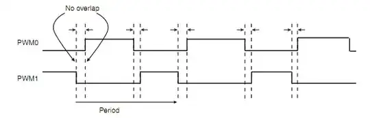

So this must be what the PWM diagram is kind of saying: enter image description here

One way could be to build your own CMOS using a PMOS and an NMOS. Look up CMOS logic or something like that to get the gist.
If you wanna do it your way, i'd hook the gates up to the same current source - one with the inverter, one without. Please note that I'm not at all familiar with the simulation environment you're using.

Using an inverter is not going to work. You need to use shoot-through protection: -
The OR gate output needs to be inverted so an alternative is to use a NOR gate. It's going to work best when both AND and NOR/OR are schmitt trigger input types. For a quick simulation make the resistor 1k and the capacitor 10nF - this will give a "dead" area of about CR or 10us but clearly the time of the dead area is dependent on the application.

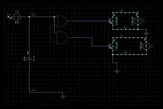

  • I tired to get as close as I could to that you posted. It's there as an edit. – Eae Jan 22 '15 at 10:07
  • The output from the NOR gate feeds one mosfet and the output from the AND gate feeds the other - don't short them together. Also, where is the RC network and, don't drive it from a current source - use a voltage source. – Andy aka Jan 22 '15 at 10:08
