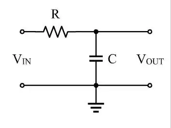

Consider, for example, this circuit from Wikipedia:
What the hell is that resistor doing there? Surely all that does is short-circuit all the power, such that no current reaches the other side at all.

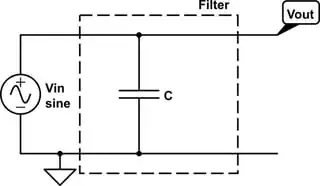

Next consider this:
This is a little strange. A capacitor in parallel? Well... I suppose if you believe that a capacitor blocks DC and passes AC, that would mean that at high frequencies, the capacitor shorts-out the circuit, preventing any power getting through, while at low frequencies the capacitor behaves as if it's not there. So this would be a low-pass filter. Still doesn't explain the random resistor through, uselessly blocking nearly all the power on that rail...
Obviously the people who actually design this stuff know something that I don't! Can anyone enlighten me? I tried the Wikipedia article on RC circuits, but it just talks about a bunch of Laplace transform stuff. It's neat that you can do that, I'm trying to understand the underlying physics. And failing!

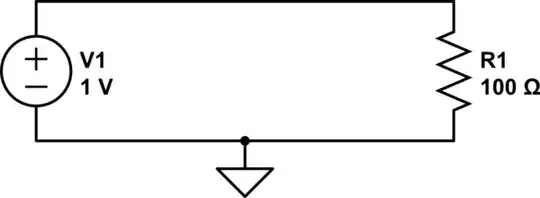

First let's consider this:
schematic
We can calculate the current through R1 with Ohm's law:
$$ {1\:\mathrm V \over 100\:\Omega} = 10\:\mathrm{mA} $$
We also know that the voltage across R1 is 1V. If we use ground as our reference, then how does 1V at the top of the resistor become 0V at the bottom of the resistor? If we could stick a probe somewhere in the middle of R1, we should measure a voltage somewhere between 1V and 0V, right?

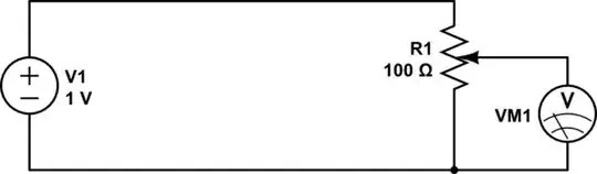

A resistor with a probe we can move around on it...sounds like a potentiometer, right?
schematic
simulate this circuit
By adjusting the knob on the potentiometer, we can measure any voltage between 0V and 1V.

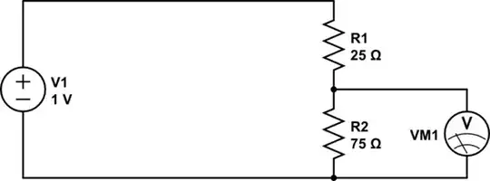

Now what if instead of a pot, we use two discrete resistors?
schematic
This is essentially the same thing, except we can't move the wiper on the potentiometer: it's stuck at a position 3/4th from the top. If we get 1V at the top, and 0V at the bottom, then 3/4ths of the way up we should expect to see 3/4ths of the voltage, or 0.75V.
What we have made is a resistive voltage divider. It's behavior is formally described by the equation:
$$ V_\text{out} = {R_2 \over R_1 + R_2} \cdot V_\text{in} $$

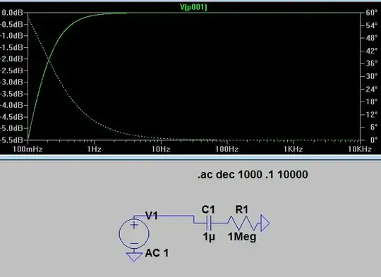

Let's look at some simulations. Say you have a 1uF cap, and your load is 1k:
Filter with smaller resistor, larger current
(Ignore the phase plot, as it's irrelevant for this post). OK, we have a rolloff starting around 200Hz. That's alright, I guess, if that's what you want. But what happens when the resistor changes? I.e., what happens when your circuit wants a different amount of current?
Filter with large resistor and small current
Goodness! Our 3dB point is now around 1Hz. So our "filter" is moving all over the place whenever something in your circuit wants the current to change! It's totally unpredictable.
So you make amends with the resistor, and you put it back, and it fixes your filter for you.
Wait-- how does R fix your high pass filter, you ask? Well, with it and the capacitor, it acts as a voltage divider! If it's stiff enough--that is, if its output impedance is much lower than the input impedance driving the rest of your circuit--it insulates your filter from changes in current draw.

When Vout is measured using an ideal oscilloscope, What we would get is Vout = Vin.
So this circuit can not work as any filter.
Considering second implementation,
schematic
Here, there is no current through C and hence here also Vout is Vin.
So the second circuit also can not work as a filter.
So one can not implement a filter only with capacitor (at least in ideal case).

  • The current that passes through a resistor is \$I = \frac{V}{R}\$.
  • The current that passes through a capacitor is \$I = C\frac{dV}{dt}\$.
  • At low frequencies, \$\frac{dV}{dt}\$ is small, so there isn't much current through the capacitor; since there's low current, there's little voltage across the resistor, and most of the voltage is across the capacitor.
  • At high frequencies, \$\frac{dV}{dt}\$ is big, so the capacitor can pass as much current as it wants; the resistor is the limiting factor for the current in the circuit, so most of the voltage drop is across the it.
  • At medium frequencies, there's a transition from the low frequency case to the high frequency case. This happens around \$f = \frac{1}{2\pi RC}\$.
  • Without a resistor, you can't tell where low frequencies and high frequencies cross over.

If you apply a CURRENT then the resistor is doing nothing and the voltage on the cap will increase linearly to infinity. However, if you apply a VOLTAGE then the resistor will 'resist' the flow of current and generate an opposing voltage drop. The capacitor will only see a part of the voltage and whatever current the resistor lets through. As the cap charges, the voltage on the cap increases and the resistor lets less and less current through. The voltage on the resistor will asymptotically approach zero.
A capacitor will no load will actually pass arbitrarily low frequencies as there will be no current path to charge or discharge through.

If there is no actual or implicit resistor in your circuit, you are driving the capacitor with either an ideal voltage source, or an ideal current source. Putting a resistor in series with an ideal current source is pointless, so the only interesting case is the one with an ideal voltage source.
The point of the ideal voltage source is that the capacitor will follow the voltage immediately. And that means that the current into the capacitor will be \$d/dt U * C\$. A jump in voltage will result in infinite current spikes.
This is incorrect in two main points:
  • Shorting means making two points the same voltage (in reference to ground), which is clearly not the case here: Assuming the resistor's value isn't zero, the voltage across the resistor is not zero.. unless the current through the resistor is. Since the voltage across the resistor is V=R*i. If one of the two is zero, then the voltage is zero.
  • Even if it was a short circuit, there would still be a current (but no voltage, since the voltage across a "short/wire" is zero. So V=R*i. Assuming it's a short (R=0), there can be a current flowing and the voltage would still be zero...
Now...
Let me ask you a question.. In the first circuit (assuming R is not zero), what would make the voltage zero? Well, no current.
And assuming you're applying a voltage across your input (at your left), why would there not be a current?
Because the capacitor is preventing current flowing.
And in which case the capacitor would do that? In which case any component would prevent current from flowing?
Answer: When a component has an impedance of infinity..
See: V=Z*I.. So I = V/Z, right?
So if Z = Infinity, then you have a null current... In other words, your component becomes equivalent to an open-switch..
Now: When does a capacitor behave that way? In other words, when is the impedance of a capcitor infinity? Well Zc=1/(jwC)..
Assuming C is not zero.. That leaves omega = 0... In other words, what you call "DC". Frequency zero.
So, let's call "gain" the ratio between the voltage at your output and input..
G= Voutput/Vinput..
When omega = 0, capacitor behaves as an open circuit, meaning your current doesn't even "make it" to your resistor, meaning volage across R (which is Voutput) is 0..
Which means G=0/Vinput=0.
Okay.. We saw the case for omega = 0..
What about omega = infinity?
Well, the capacitor then behaves as a closed switch.. Which means: Vinput=R*I=Voutput.
Which means G=1.
So.. Our circuit's gain is 0 in the low frequencies, and 1 in the high frequencies... In other words, it lets high frequencies pass, and blocks low frequencies.. In other words: A High Pass Filter.
Can we do our second circuit?
Omega --> 0 ===> Capacitor is open circuit (remove it from your schematic). All you're left with is Vout = Vin.. So gain G = 1.
Omega --> Infinity ==> Capacitor is a short circuit, and Vout = 0, so G=0.
In other words, that circuit lets signals of Low frequencies pass, and blocks high frequency signals..
It's a Low Pass Filter..
