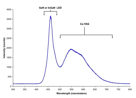

@Shamtam have already commented that:
(1) the light from a typical while LED doesn't match the spectrum of the sunlight
(2) white LEDs are blue LEDs with additional phosphor
This is to expand on @Shamtam's comment.
enter image description here Spectrum of a white LED showing blue light directly emitted by the GaN-based LED (peak at about 465 nm) and the more broadband emitted by the phosphor.
(source: Wikipedia)
enter image description here Diagram of the spectrum a LED lamp (blue), a CFL (green) and an Incandescent (purple) superimposed the solar spectrum (yellow). Note that the energy used by each lamp is at least the area underneath its curve.
(source)

Quick answer - Shantam to the contrary, yes. But let me explain.
Nick Alexeev provided a spectrum from a typical white LED. While it is not a faithful simulation of an incandescent (the big spike in blue is notable), it does contain all visible wavelengths. Your question asked "Does a light like this produce a full spectrum of light, such that appropriate light filters could produce any spectrum of visible light?", and the answer is obviously yes. If you wanted a predominately green light, for instance, it wouldn't (relatively) be very bright, but you could do it. This is not true for RGB LEDs, which would have very narrow spikes of intensity at 3 different wavelengths, with nothing in between. So, while you could easily produce a subjectively yellow light from an RGB LED source (just transmit red and green in the proper intensities), a narrow-band yellow filter would transmit nothing.
