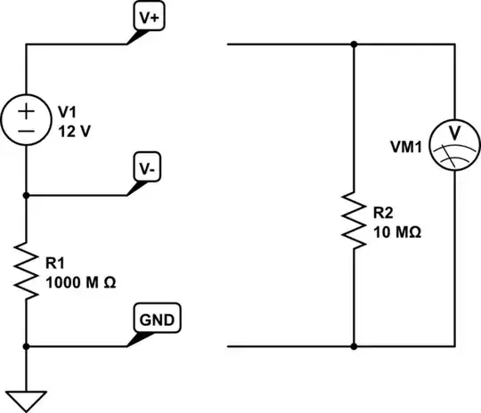

Because the supply is floating, and you only made one measurement at once.
Floating means isolated, which means the resistance between the supply and ground is very very high. So high that the 10 Mohm input resistance of your multimeter is almost a short circuit in comparison.
schematic
If you were to make both measurements at once, with identical meters, you would find V- at -6V and V+ at +6V with respect to ground, and 12V of course between V- and V+.
  • Thanks, nice schematic. So in essence I did tie the measured line to the ground? Similar to a pulldown transistor? – Sebastian Jan 07 '15 at 12:58
  • Yes, more like a pulldown resistor than transistor. It's worth remembering that the act of measuring something always modifies it - in this context, by the fairly major addition of 10 Megohms or whatever your multimeter is. Also note Andy's comment re: AC measurements - you may get a surprise there. –  Jan 07 '15 at 13:38
