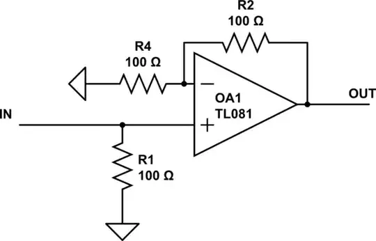

UPD: Added the schematic to avoid misunderstood. The schematics a little bit differs from the schematic in the question Use of 100K ohm resistor along with 0.1uF capacitor? So then maybe my question is not duplicated...?
schematic
The values of R2 and R4 (as well as value R1, though) are default cause they don't matter in this scope. We discuss the role of R1.

I've found out one more opinion that seemed for me to be suitable.
They say, that this resistor (R1) can help to attenuate some noise which source has large internal impedance. Source of noise and this resistor forms some kind of voltage divider and this divider attenuates the noise significantly.
It seemed to be possible explanation.

As a general rule, all inputs of any kind need a DC path to ground. If you don't have a DC path to ground, the DC offset of the input can float to any voltage. You have capacitive coupling to the AC input, but you also have (weak) capacitive coupling to the rest of the circuit, the power lines, your body, etc. All of those can influence the DC component of the input voltage. A resistive path to ground (or a DC-coupled input signal) overpowers these other effects and forces a well-defined DC offset.
Why do you need a well-defined DC offset? If you don't have one, your input voltage could easily drift beyond the supply voltage range, saturating the op amp.

    This answer pertains more to FET-input operational amplifiers which have a very high input Z, and low bias currents. BJT input op-amps need a path to ground simply so that their bias current has somewhere to go. If the only place it can go is a coupling capacitor, it will charge it. No stray fields are needed. – Kaz Jan 06 '15 at 18:19

  • This resistor (why so low?) is necessary only if an input coupling capacitor is used which does not allow the necessary (small) input dc bias current. In many cases this small dc currrent (nA range) is allowed to flow through the signal source. In this case, you should not use such a resistor because it unnecessarily degrades the input resistance of the whole circuit. – LvW Jan 24 '15 at 12:36
