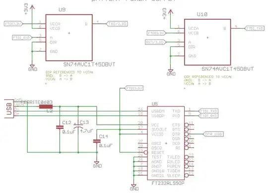

I can confirm that using two 74LVC1T45 will work, as answered in (my question): A circuit to prevent parasitic powering of FT232RL by MCU, will it work?
This is my working circuit:
I use a jumper (not shown) to connect FTDI3.3V as the 3.3V supply to the rest of the circuit.

  • DO you only connect the jumper when the FTDI is in operation? Or is the jumper permanent? I'm looking for a solution where no manual intervention is necessary. – darudude Dec 23 '14 at 12:31
  • @darudude The circuit is normally powered by the battery using a LTC3525-3.3v boost converter, except for the FTDI which is bus powered. The jumper lets the FTDI power the rest of the circuit when no battery is present; it is not permanent. To automatically switch between the two you need some extra circuitry. Your circuit runs on 5v? There are quite a few ways to do this... – geometrikal Dec 24 '14 at 21:32
