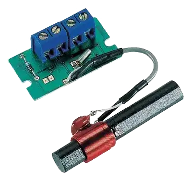

The solution for timing long periods is to synchronize your timer to a high precision clock. DCF77 (Europe) and WWVB (North America) send a pulse every second, a timing derived from an atomic clock. You could count these second pulses for timing the longer periods and for sub-second timing rely on the crystal.
edit
The picture shows a DCF77 receiver module by Conrad:
