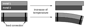

In surface-mount designs, the differential temperature coefficient of expansion between the parts-soldered-to-the-circuit-board and the circuit board can cause large stresses. The stress-strain-temperature relationship often barely works over the specified temperature range. When the equipment is powered up, the hot components can change shape and break the brittle plastic, much like my old ice chest.

An IC is made up of different materials. The die, the substrate, the bondwires, the bonding method, the legs and the body. As the temperature changes, these different materials expand/contract and will rip apart from other materials not changing at the same rate.

  • many electronic devices are made of diffrent materials and they may act like bimetal break when you change temperature in wide range. In many cases manufacturers do what they can to avoid this by using materials with similar coefficient of thermal expansion, but sometimes this is impossible or just not required
