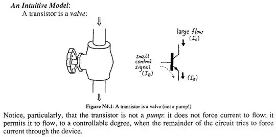

Yes, a transistor is like a variable resistor, in that the resistance between collector-emitter or drain-source is variable. It's like a valve, and either allows current to flow or blocks it from flowing. (I don't like it when people say "transistors are amplifiers". They're a part used to build amplifiers, but they can't do anything themselves, without a power supply, biasing circuitry, etc.)
The difference from a potentiometer is that the resistance of the output is not directly proportional to the current. It's more like a current-regulating valve. It adjusts its resistance as well as possible so that the current at the output is proportional to the input.
This is from the Art of Electronics Student Manual:
transistor is a valve not a pump
