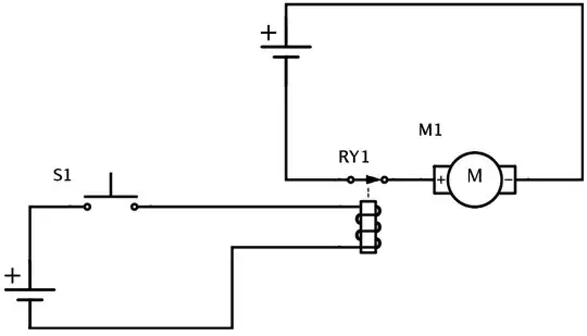

I am looking at creating a 'quickshifter' for my motorbike. The way this will work is by breaking the ignition circuit(signified as M1 motor) momentarily using a 'normally closed' relay(RY1).
The problem I am facing is that the circuit will stay broken for as long as the switch (s1) is pressed. I am looking for a solution that will only leave RY1 open for a specific amount of time, in the 50-100ms range.
I would like the circuit to be broken for a maximum of 50-100ms; this is regardless of how long the button is held down. So for example. If I press and hold the button/switch, the relay will be trigged within the first 50-100ms, but not again until the switch/button is de-pressed and re-pressed.
What logic could be used in order to achieve this? Apologies for my incredibly crude diagram.

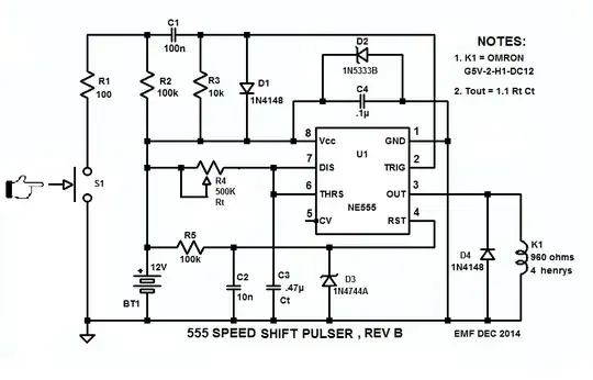

This'll work for you: enter image description here
and if anyone wants to play with the circuit, the LTspice simulation is here.
There's a 1 second delay built into the sim, just because, but in the circuit above, as soon as S1 is pressed, K1 will go hot and stay hot for 1.1RtCT, no matter how long S1 stays made. Then, when S1 is released and pressed again, U1 will make another single pulse.
Just as an aside, Ct is 0.47µF, so for U1 OUT ~ 100 milliseconds, Rt needs to be 200k ohms, which is about halfway around R4, a rheostat-wired 500k pot.

  • Looks great. Going to be building a prototype of this tonight. Thanks @EMFields – Jack Dec 08 '14 at 15:13
  • Hey @EMFields - I've had a go at creating a PCB with your design. Can you tell me whether or not this is 100% right? From what I can tell it should work, but you'll know more about bet practices than me. I have replaced K1 with M1 for my example..; http://pixxl.us/i/HsZn.png – Jack Dec 09 '14 at 11:04
  • It seems there was some confusion about the 555's pinout and, as a consequence, it's shown on your layout wired dead-bug. I added the 555 pinout numbering to the drawing to make it clearer. There are other errors on the board, like C4 is missing and, according to U1's orientation, pins 6 and 8 are connected. There may be more, but I stopped there. – EM Fields Dec 09 '14 at 14:25
  • @Jack: RevB: Change R1 to 100k and C1 to 100nF for better S1 bounce reduction. – EM Fields Dec 09 '14 at 23:56
