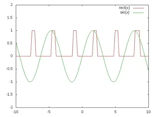

case one

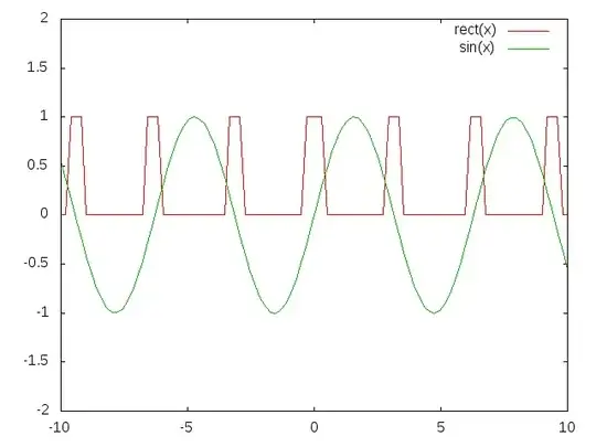

case two
In the first picture the load is switched on about half a cycle. And in the second it's switched on the whole time. But the only difference between these two cases is the phase of signals.
