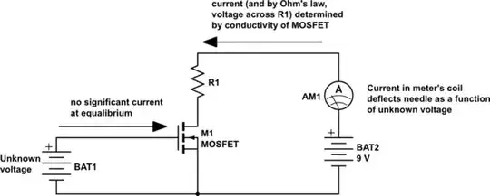

Many of these devices are very old and require very high voltages to work. However, modern MOSFETs are essentially the same thing at a microscopic scale in that their input looks like a capacitor. Instead of deflecting a ball, the voltage modulates the conductivity of a semiconductor:
MOSFET structure
The MOSFET works by altering the conductivity of a channel between the source (S) and drain (D) as a function of the voltage between the gate (G) and the bulk (B). The gate is separated from the rest of the transistor usually by a thin layer of silicon dioxide (white in picture above), a very good insulator, and like the diaphragm device before, whatever very small leakage there is isn't relevant to the operation of the device. We can then measure the conductivity of the channel, and the current flowing in this channel can be supplied by a separate battery and not the device under test. Thus, we can measure a voltage with an extremely high (theoretically infinite) input resistance.

    Perhaps I'm missing something but in your example dc current has to flow to bias the FET. Or was your first paragraph just rhetorical? Or can we really derive a way to measure voltage without electron flow? – user6972 Nov 30 '14 at 21:06
  • @user6972 MOSFETs don't require a DC bias current, except for a very, very tiny current that must exist only because perfect insulators don't exist. This is why CMOS is the topology of choice for CPUs, what enables flash storage, and why MOSFETs are so sensitive to ESD. To prove it to yourself, light an LED through a MOSFET on a breadboard, then disconnect the wire connecting the gate to Vcc. The LED will stay on for quite a long time because the gate capacitance remains charged enough to keep the MOSFET on. – Phil Frost Nov 30 '14 at 23:02
